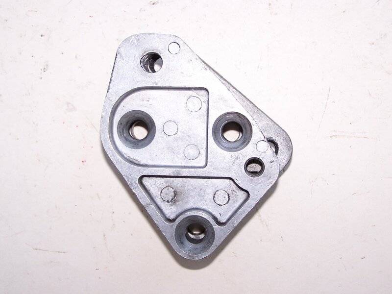

        Here is a pic of the 1969 Factory Hurst Shifter and Rods.
        The second picture is the aftermarket Hurst Competition Plus Shifter and rods on the same transmission.
        When you bought the aftermarket Hurst Comp Plus Shifter kit it, included the #2298 shifter mounting plate.
        The #2298 shifter plate is the same one that was used on the 1964-65 A-body 4 speeds.
        The 1968 and later factory installed Hurst Shifters used the #0090 mounting plate.
        If you look close at the two assembles. You will notice that the aftermarket Hurst Comp Plus Shifter sits more upright,
        but the the factory Hurst shifter is tilted forward.
        The last picture shows the two mounting plates sitting on top of each other to illustrate their differences.
        There are also differences in the shifter arms.
        The lesson is that you cannot interchange the rods between the two.
        I know, because I tried to do so and I ran into fitment problems.

        that's good info, thanks. this is the shifter i've actually bought, it's used (of course) and from a guy on another forum here in the uk.

          What you have in your picture looks to be the 1964-65 A-Body factory Hurst shifter.
          Those A-Body shifters did not have the positive stop bolts.
          If it does, then its 1964-65 B-Body factory Hurst Shifter.
          Those shifters were different than the aftermarket Hurst Competition Plus shifter that is in my picture above.
          • Agree Agree x 1

                Here is another picture that I took back when I was finding out about the differences between the two shifters that came with the 69 Dart GTS.
                The picture shows the two shifters side by side. All three arms are a little different on the Hurst Competition Plus aftermarket shifter when compared to the factory Hurst shifter.
                Also note the blue arrow pointing to where the reverse arm on the factory shifter does not have an alignment hole drilled into it and where the aftermarket shifter does have one.
