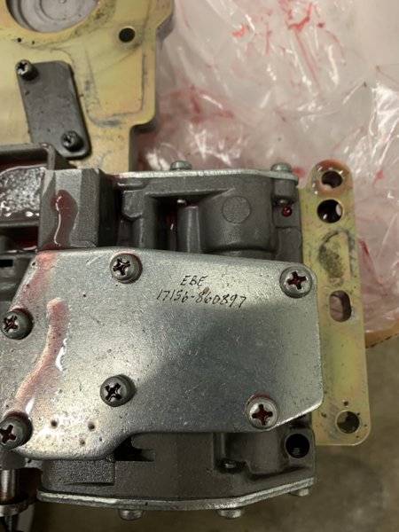

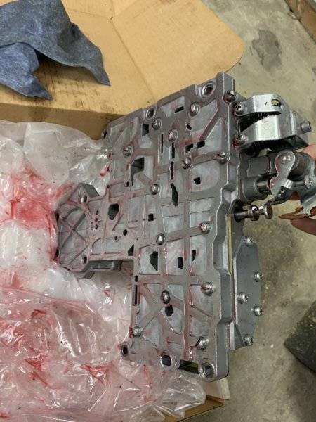

Post some pics of what u took out. Did u drive this b4 and after the vb swap? If it was a forward manual shift there could be a plug in the governor port in the trans. Also a restrictor in the high clutch port in the trans. Is it reverse manual? More info is always good. Kim
Take a look in the governer passage in the case. If it was a TF3 manual conversion valve body, that passage gets a plug.
Also there were two different transmission case castings from 66-later. Different behind the accumulator. I'm still trying to figure out how much mixing and matching is allowable..

The valve body I removed was a cheetah manual reverse VB.

Below are pictures of the VB I just removed as well as a couple pictures of how my throttle and linkage are set up. You can see in the pic, when the throttle is 100% the kick down is also at 100%.
So then there won’t be any plugs/restrictor put into the case. Back off the cable and see if it shifts all 3 gears. If not back it off all the way so the lever on the trans will be all the way to the front. Test drive again and let us know. Kim
It would make more sense if it took off in third and you could get first and second manually. But, according to what you described. I would tend to condemn the valve body.
