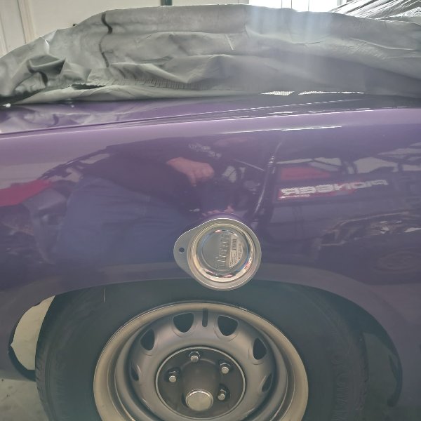

Hi everyone. I'm picking up a 67 FB this weekend and will want to do a wheel/tire upgrade. Info on doing this upgrade will be greatly appreciated. Thanks in advance. I'm attaching a pic to get clarification on whether these are the small bolt pattern.
5 bolts so you measure from the edge of one lug hole to the center of the opposite lug like the image below. I don't think anyone could tell what you have just by eyeing it from a photo.
