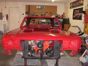

Like this? I left a post on the Mopar Muscle website but Randy hasn't responded yet.
Pntastar69,
That looks spectacular! Found a pic with original blackout. I thought I took lots of photos but I should have taken more.
Found another pic of core support, mine was not painted on the bottom of the support but I agree it looks better. The black does not cover the latch reinforcement so I may not cover that part fully.
