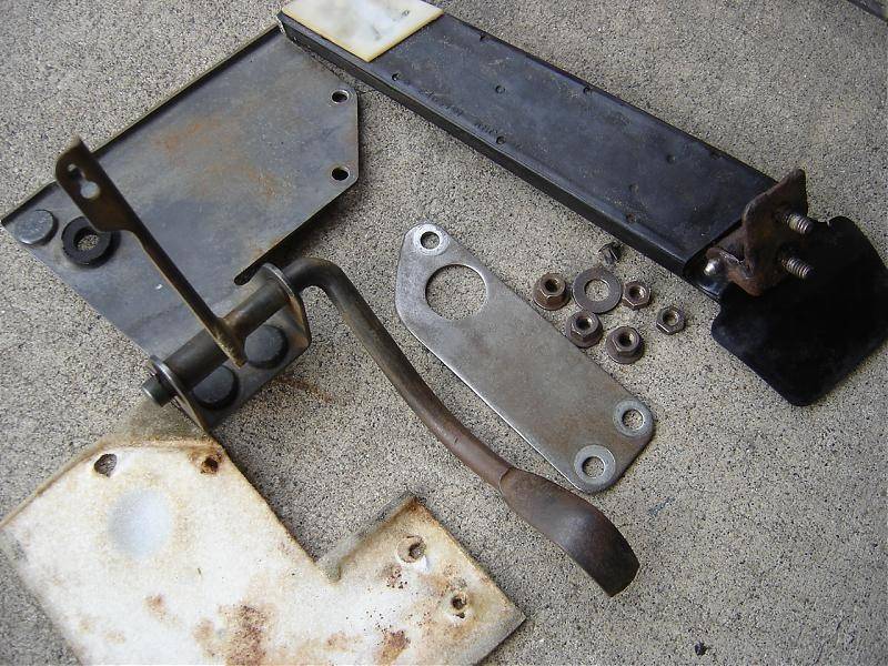

Does anyone have a picture of the correct gas pedal assembly for the 2bbl (super six) conversion for an early (63) A? I want to use the floor mount pedal assy that just bolts in the original location just by drilling out the dimples already stamped in the floor. Thanks in advance! Tim

The correct pedal is off a Early a body veight car or slant six with a/c looks like this
No, the 63 has a different firewall than 64-66 and the 64-66 V8 throttle bracket won't fit a 63 firewall. See my answer to the OP's cross-post in the early A forum.
