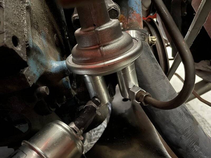

Filters are best installed on the pressure side, not supply side.
No, not at all. That’s the exact factory setup. In fact there is a threaded hard line between the pump outlet and carb inlet. Parts book shows some generic diagram but that’s not for this one.
In fact, as mentioned,I bought this car new, have owned this car for 51 plus years.
Often a small filter is in the carb inlet on some different models
From the factory there was a filter on the supply side. The line going from the fuel pump to the carb was one solid piece of steel tubing threaded on both ends. It is smarter to keep the filter on the supply side so that you can use a solid piece of tubing from the pressure side to the carb. This minimizes the potential for a fuel leak on the top of the engine from either the fuel filter or the inevitable rubber hoses that attach to it. The way the factory did it meant that most old rubber related fuel leaks would be under the engine, less threat of a fire there.
The odd thing is, I have looked at 71 models and they have the filter after the pump but it’s fastened into a short rubber hose with the same clamps right next to the carb. Definitely easier to create a leak in the top of the engine. Im not sure when that changed but mine is as you mentioned, threaded hard line from pump out to carb in.
I have a 72 Duster 340 and the fuel line is solid from the fuel pump to the Thermoquad, the filter is before the pump, and that is how it came from the factory.
Yes. Same as mine. That’s for 72. But the odd year 71 with a thermoquad air metered vs 72 and after, so called solid fuel, has the other setup with the filter up by the carb. So when they changed the carb design from 71 to 72 I guess someone figured out the solid hard line from pump to carburetor was better and safer.
The picture below is from this site of a 71? maybe, with the filter after the pump. So I’m not sure if this is completely accurate for a 71, but if it were mine I’d probably retrofit the 72 hard line.

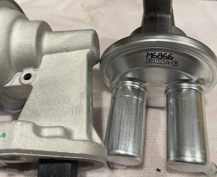

I compared the pics from this thread and the instructions as well and both of these pumps had the exact same instructions but paper and gaskets are different.
Pump castings are different.

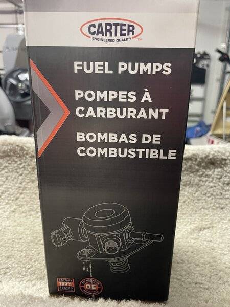

I will attach pics of the two pumps one Mexico made and the other is Korean.
The Mexico pump is the newest and what Carter is selling now, It will be on the right in all the pics. I think it looks to be better quality and it is from Rock Auto at about $12 bucks plus shipping.
The pump on the left is the Korean pump and is no longer produced but will be sold as there are pumps left over from pre covid.
I do not have pics of the China pump but would stay clear of that one. Carter only used these during the covid period.
Origan of the pumps will be marked on the bottom of the boxes.
