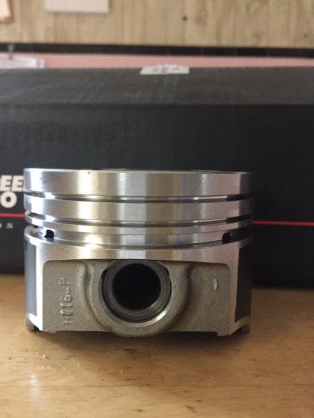

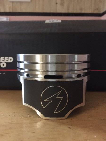

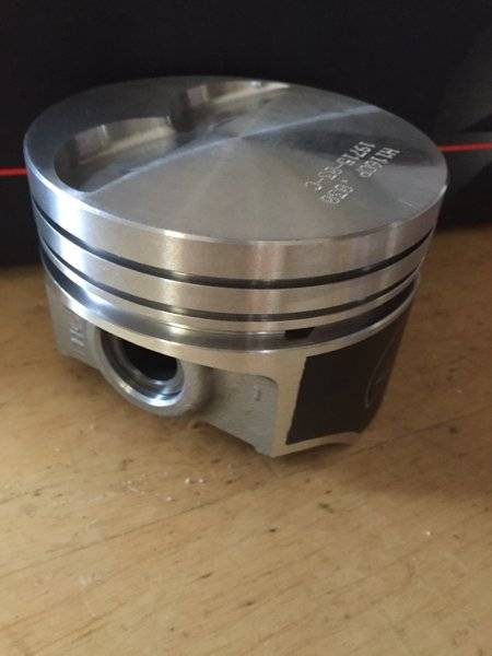

          You asked about the lower end. As a minimum, for north of repeatedly 6500 RPM blasts on a track, a better piston should be employed. You could use a Hyperutecic very well. I personally like a flat top, 2 valve reliefs. You can find that with a KB-107 or the Speed Pro (H116CP) slug pictured below.
