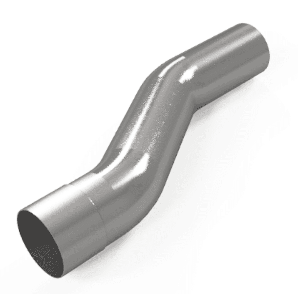

                  Here's the dimensions off of jegs website. Doesn't have to be exact but enough to clear torsion bar hump I'm working on a B-Body.
