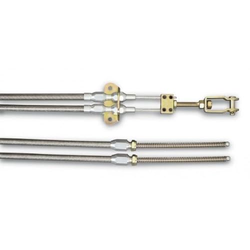

I'm planning to use the Lokar hand brake with the lokar cables. I've got the part numbers for everything but just haven't had the time/money to purchase everything just yet.
Should be by spring though.
Here's what I'm planning to use.
Lokar Hand Parking Brake - EHB-7000F(Chrome) and XEHB-7000F(Black)
Lokar Hand Parking Brake Boot - 70-EHBF
Lokar Parking Brake cable kit for Wilwood - EC-81FU(Black Housing) and EC-81FHT(Stainless Housing)
