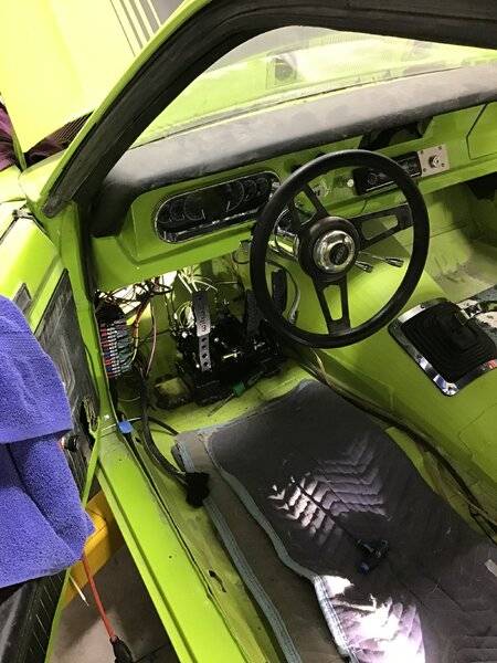

Had this made for my Dart, but you could transplant another one, just need to fab a little.
