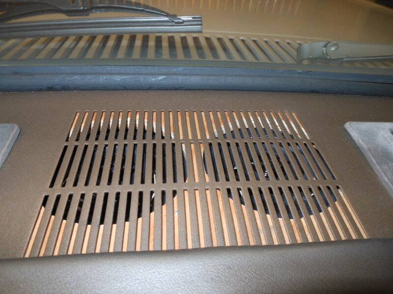

Stretch some speaker cloth over the unit before you install it the final time- it's surprising how they stand out under the grille whenever you look in through the windshield.
Nice job!
Agree with the Professor. Paint everything black and use the speaker cloth to hide it.

As others have said. Speaker cloth. I bought some at Joann fabric and used industrial hot glue to attach to the underside of the dash speaker vent. covers up being able to see down in there and keeps things from falling into your speak cones.
Our local Joann's has it in stock.

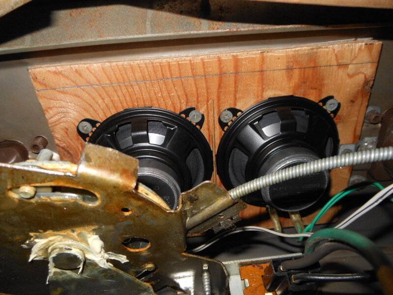

I did these 4" Kenwoods in my 66 Valiant, just made a mounting board from a chunk of plywood and secured it to the dash with plumber's tape. It's cheesy but it works and sounds good.

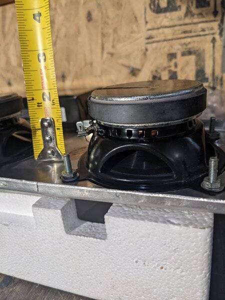

I just this last weekend put this pair of Infinity 3.5" in a metal template I bought from (someplace I can't remember...). As above, they look and sound good.
