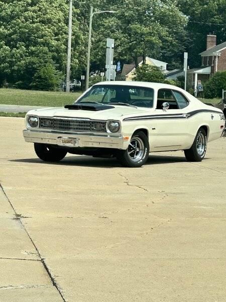

Hi, all had my 73 Plymouth space Duster for about three years now. Would like to get it to the finish line in the next couple of years. The car came with a shear grip 7 1/4 rear end when I bought it. It was an original slant six but has a recently rebuilt 72, 340 it now.. have also rebuilt. The therm quad carburetor runs pretty good but without knowing the specifics on what was done to the motor I’m having a hard time getting it dialed in especially the timing.. has a stock electronic, ignition and distributor, but only seems to run optimally on a mixture of racing fuel and pump gas about 50-50 on stock high octane fuel. I’m getting some pinging and knocking. also hard to restart after it warms up timing is set about 15° above TDC. Was thinking it just might be too far advanced for this engine . Also, was looking into putting a larger rear end in the car before this one ends up broken or maybe build one for a spare in case this one does break. Anyone know of a cheaper solution than buying an expensive Moser or other aftermarket rear end and is the Ford 9 inch rear end a good option for this car and cheaper to build. I did not build this engine, but I believe it has a mild cam upgrade also has stock headers freshly rebuilt, 727 automatic trans and 391 rear end. It’s a fun car to drive but the high RPMs are no good for the highway. Any suggestions?
