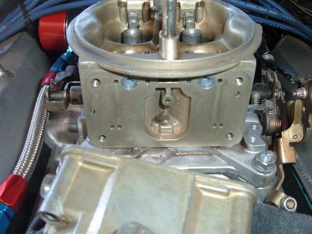

i wanted to hook up the vacuum advance but when i put a gauge on the ported vacuum port in the side of the metering block it stayed at 0 while driving around. direct vacuum gave me these numbers: idle 12", cruise 15", and coasting (4spd) 20"
shouldnt ported vacuum be active while your driving but be zero at idle? im confused. i just want to get the vacuum advance working to improve its manners and it also seems a little lean which i think is weird. i havent even got on it hard yet because it feels like its bogging and i dont want to cause any issues. Any input at all is greatly appreciated, thanks in advance! :thumblef:
I'd say we need a photo of your carb. Maybe you have the wrong port. The other possibility is that either the metering block/ body has a plug or a flaw, or even a bad gasket.
You are right, a ported vacuum fitting SHOULD bring up vacuum as you drive around. You should also be able to bring up RPM to a "high cruise" setting, hold the throttle there and observe vacuum
thanks for the quick response! thats the reassurance i needed before taking it apart to look, ill see if i can get a picture up. if it worked i circled what i think is the ported vacuum in green. the blue tip sticking out from under the bowlis the plug on the direct port that i got readings from

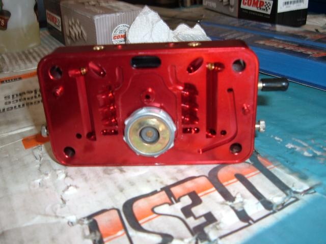

so i swapped out the power valve for a 8.5 and while i had it apart i investigated the lack of ported vacuum and it seems the proform main body doesnt have it. where do i go from here?
i have been researching it and it sounds like the main body can be drilled for ported vacuum, has anyone heard of or done this themselves?
