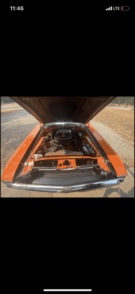

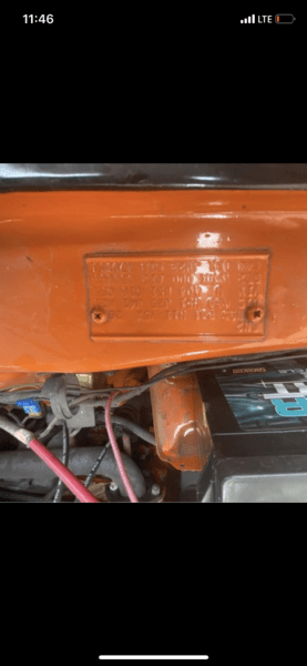

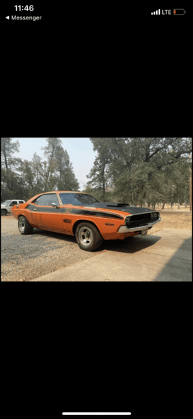

Hello all I am looking at a 71 challenger T/A with a 440 six pack under the hood. I’ve been trying to do research on this specific year/engine/trim and I only see it popular in 1970 under the 340 six pack. The seller is showing body tags I just don’t know enough about them to make sure this is legit a 440 in the t/a in a 71 challenger. Thanks for the info!
No. No such animal! No T/A's in 71, no T/A's with a big block.
Completely fabricated car. If you don't have a problem with that, and the price is good......
...but that car is a one of none.
Fender tags are counterfeited all the time.
If you want it, pay for a big block challenger, NOT some exotic rare car..... cause it aain't!
(I wouldn't even believe a broadcast sheet, even if he has one, and he wont!)
Nothing legit about a 71 TA 440+6
Can you post a picture of the tag? Then we can tell you what it really is.

A legit T/A will have a second fender tag that simply says "TRANS-AM" in the middle of it. It will be affixed using the rear most rivet/screws of the main tag.

That is a 71 318 automatic Challenger.
Tag is very hard to read in that photo, the codes you typed aren’t right either. Is that the only photo of it?
I posted w
Unfortunately yes. It’s very hard to read. I have not seen the car in person this is only the picture on the sellers ad
