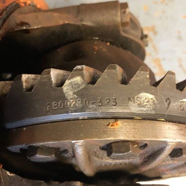

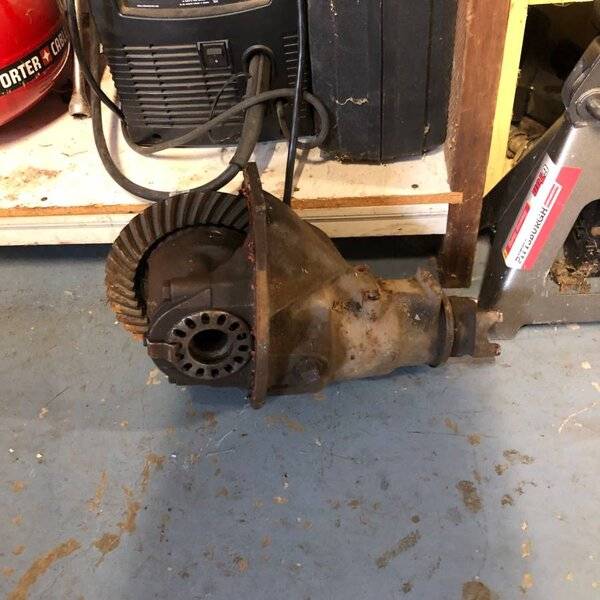

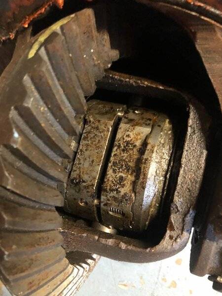

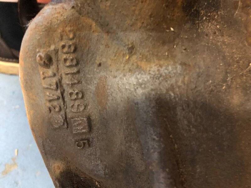

I recently scored a 489 case fully assembled with the exact gears I want (3.23) and what the guy says is a richmond sure grip unit. Need help identifying it. He said he got it from summit 10 years ago or more. He stuck it in an old wagon for whatever reason and drove it around his property, never on the street. I asked him if if it had a crush sleeve or eliminator and how it looked on the marking compound after he put it together. He said he didn't use compound. I shook my head, handed him 325 bucks and walked away with the unit. Me and my father in law (fully trained deisel mech and has done front to back on cars too) did roll some very thin white tissue type paper (like you stuff in a gift bag) around the entire ring gear as it contacted the pinion and it looked REALLY good. I may have it double checked at a shop or get a can of stuff and with guidance here from you geniuses check it myself.

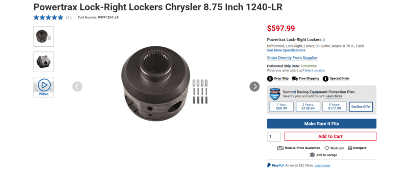

Unit is a lunch box locker installed in the open carrier center section.. no sure grip there.
