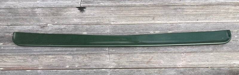

No photos of it on the Charger, I took it off soon after buying the car, that was 15 years ago

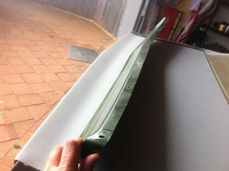

This is the one I built for my 73 Scamp kinda looks
familiar to yours.

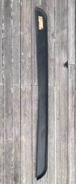

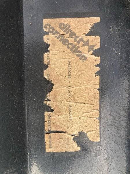

Scamp one looks good. I got a postal estimate to send from NZ to USA, and was outrageous... over $400 USD, and that was using measurements smaller than the spoiler (online calculator wouldnt take the actual length of the spoiler) so would be even more than $400. I could try one of our shippers, but would be sea freight, 4-6 weeks. Took some fresh pics too btw

Yea that's way to much money.
Looks simple to build though and a real shame not to reproduce it.
Any way you could get someone over there to make them?
Would still have the same problem of expensive shipping to get them back to any buyers in the USA

I had a quote to accurately laser scan this, accuracy 0.07mm, post-processing and an 'STL' file is made. Not cheap either, works out around $600 USD just to get the scan done

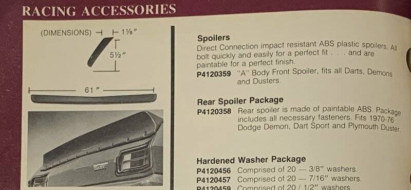

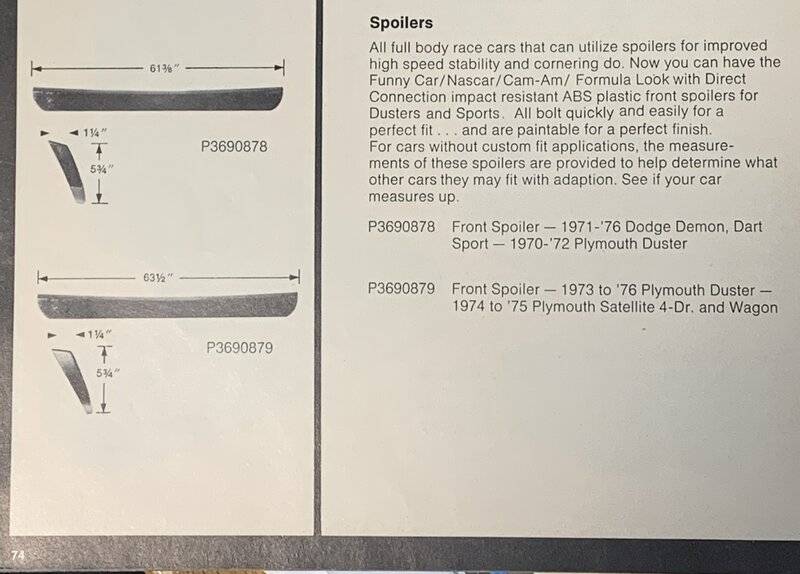

@Frodee FWIW, I think yours is better. The 73+ bumper isn't flat on the bottom and you made the contour of your air dam match the contour of the bumper.
There isn't a contour on the Direct Connection one. At least, it appears flat to me and would be better suited on a 70-72.

Mine bolts to the bumper brackets on my 73 not the bumper. I made the contour to help with air flow to the radiator.
I'll get you some pictures. Also I can change them so if someone wanted a taller one or shorter in height.
