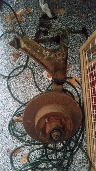

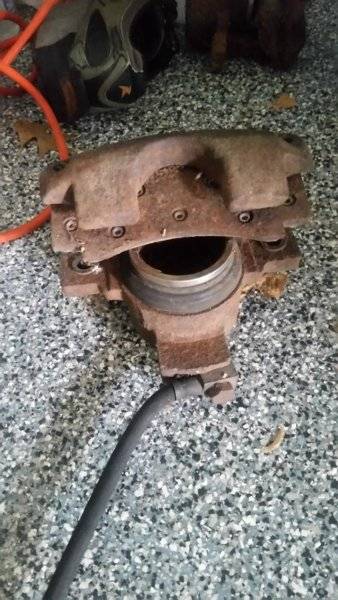

Hi all,
I'm looking to upgrade from my stock 9" drum brakes to disc. I got the brake related parts shown in the pics below (including the four wider rims) from the Dart's previous owner. Not sure if these are worth saving and reusing or just as cores etc but would love any input or advice on where best to start looking for the rest needed to upgrade my brakes (I plan to leave the rear drums for now until I swap out the rear end from the stock slant six 7&1/4). I've come across a few brake sellers but am not familiar enough to have a good feel of where to look or what might look like a good deal but isn't worth the time/aggravation etc.
Thanks for your help as always!
Well for one thing those are 73 up, "B' body pin type calipers in your picture, that won't work on an A body car, due to the fact where the rubber flex hose, brake line attaches to the caliper.
There have been dozens and dozens of threads on these disc brake conversions, and what to do, use, for the conversion.
Use the search feature on this forum, and GOOGLE will also be your friend.
And those upper control arms won't work either.
They are 73 up, B body UCA's.
You found a "B" body set of brakes.
Mostly agree with hemi71x. The spindles will work for you, the UCA's won't, and I wouldn't waste my time with anything other than the spindles. Turn the calipers in as cores and buy some new rotors and bearings.
You can run pin type calipers on an A-body, it's not that big of a deal. You just have to use different hoses and plan the routing out that's all. It doesn't work well with stock parts, but there's plenty of hoses available to make it work.

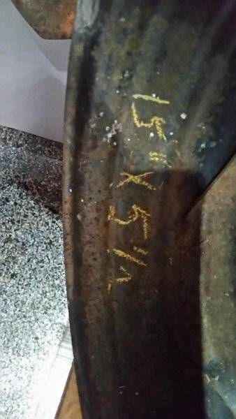

You forgot to mention that new wheels and tires may be required, as a lotta stock wheels won't clear most aftermarket calipers, particularly Wilwood. ! !

Correct. The Wilwood hubs in the kits for A-bodies now require a center hole diameter of 3.050", which means stock wheels won't clear them. It actually means a lot of aftermarket wheels won't clear them either.

Jim I totally agree. StPaulSwinger can use the 73+ parts he has with some new and reconditioned parts and he'll have excellent brakes, and he doesn't even have to worry about considering significantly more expensive options.

Another reason to consider the Wilwood path is that it offers two bolt circle patterns. I like my current wheels and they are 4". However there greater wheel choices in the 4.5 bolt circle pattern.
The last time I tried to put a 14" Rally wheel on a Wilwood, it wouldn't mount on the studs cuz the caliper is way too big, and in the way. Same with a regular 15" wheel. I hope someone can shed some light on that.
The price of the brakes is high, but to then find your favorite wheels don't fit, could be annoying and costly to say the least. cheers

Pretty much none of the stock wheels will fit the Wilwood brakes anymore. The hub bore for the Wilwoods has to be 3.050" with their new redesigned hub, and that's larger than pretty much all of the stock wheels. The wheel studs used are also 1/2", so they won't usually work with stock wheels because the stock SBP studs were 7/16". And the rallye wheels don't clear the calipers.
So, there's really no advantage to using the Wilwoods to keep the SBP. You have to buy new wheels anyway, might as well go BBP. Heck, with a hub bore of 3.050" a lot of BBP aftermarket wheels won't fit either.
