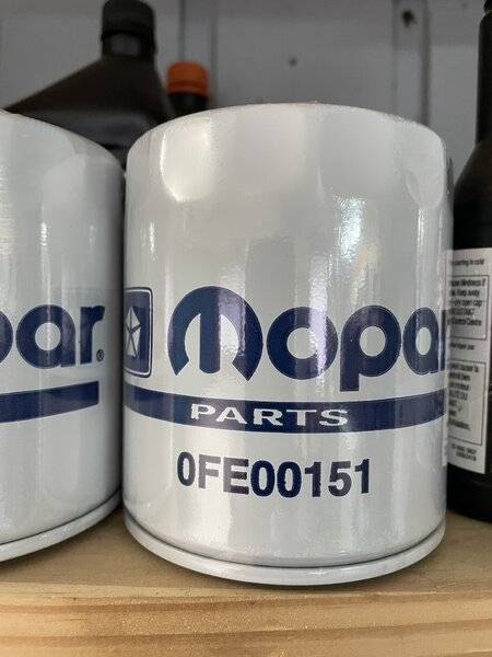

The 0FE00151 is a Mag/Mar quick #.

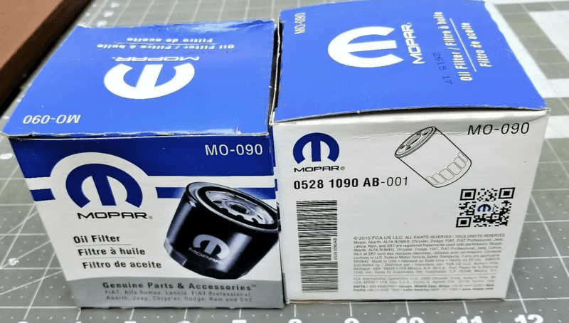

You can use a Mopar 5281090 (may have a "bb" or "ab" after the part number).
You can also Mopar 4105409 as well. It's a smaller profile oil filter but will work just fine.
Walmart and parts stores sell them as M0-090 or M0-409. Again, just quick #'s.
