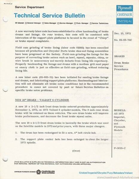

My Chilton's Dart & Demon Repair & Tune-up Guide 1965-1972 page 205 shows 1970 6 cylinder cars had 10" front drums and 9" rear drums. All other years had 9" drums front and back. My 1970 Dodge Challenger Dart Service Manual page 5-54 also shows 6 cylinder Darts had 10" front drums and 9" rear drums.
My Chilton's Valiant Duster Repair & Tune-up Guide 1968-76 page 183 shows 1970 6 cylinder cars had 9" drums front and back, however, 1973-76 all drum brake cars had 10" front drums and 9" rear drums. For some reason 1970 Dodge and Plymouth A-bodies were different in 1970. I don't know for sure but 1973-76 Darts were probably the same as Valiants and Dusters.
I've only had a couple of 'A' body cars and have parted a couple and don't remember them having different diameter drums on them......oh well. Learn something new all the time. My 66 /6 Belvedere had 10's.....10x2 on the front and 10x 1 1/2 on the rear. My rears were grooved to the max and couldn't find any replacements in 1990 so I cut them myself. Took .100" out of them and they didn't clean up but ran them anyways until I could swap out the 7 1/4 rear for an 8 3/4. The over cut drums worked and never blew apart even after 'testing' them :D
