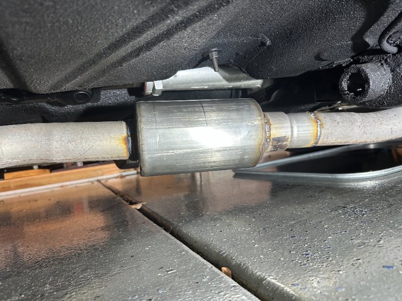

I bought some Aero resonators and my shop added them right after the engine. The car sounds great when idling and sounds like my Subaru when driving (except for the engine noise). Wife is happy, so I am happy. Night and day difference. No more brain-numbing droning.
Aero Exhaust Resonator - tr225 TR Series - 2.25" Inside Diameter Necks

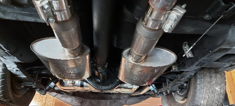

I recently installed 2 new MagnaFlow mufflers to my 440 1969 Dart. They are loud and drone, especially around 2000 RPM. I've read that you can add heavy-duty band clamps at random points along the exhaust pipes do help reduce droning.
Has anyone done this? Does it work? What kind, how many, and where do you place them?
Thanks!
First I've ever heard of it. I don't see how it could, since drone comes from the resonance inside the exhaust.
