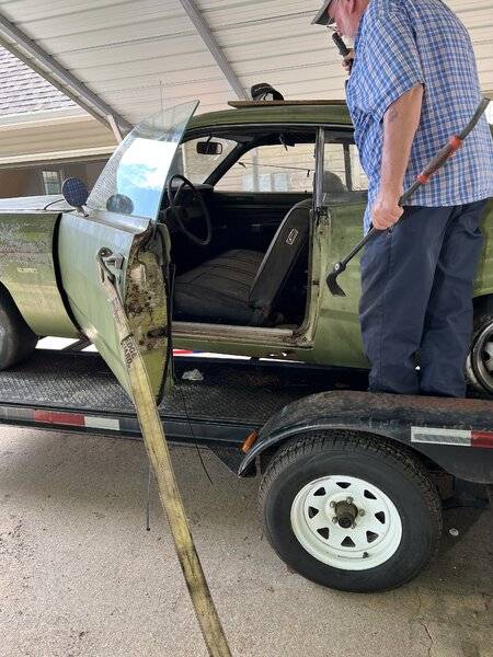

Victory! Got my old man to help me out with it today. After several more sessions of soaking the latch, hammering the lever inside the door with a long screwdriver, and ratchet strapping the door handle to my carport and slowly adding pressure, it finally opened! Now on to the next challenge, cleaning the disgusting interior out.
