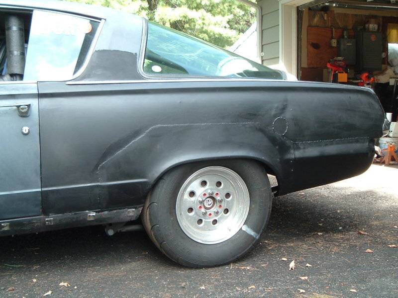

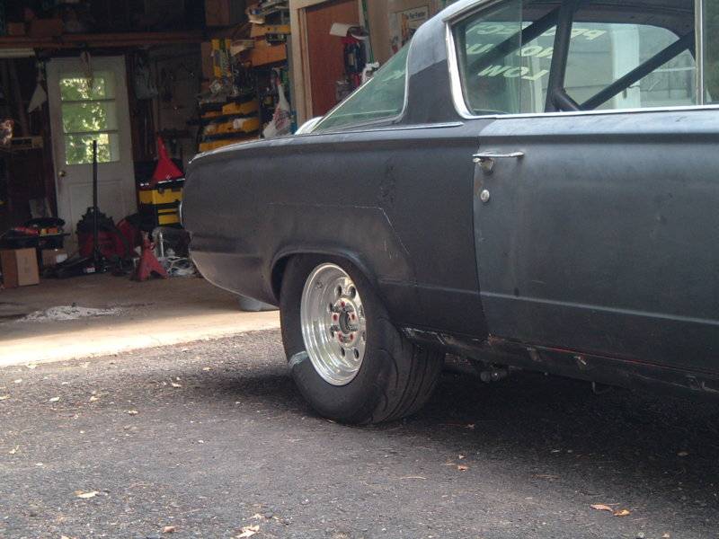

      FWIW....MP 3/4 inch off set shackles, front hangers, moved spring pads, 275/60x15 M/T Drag radials, 15x8 rims with 4 1/2 inch BS, rolled the lip of the wheel opening
