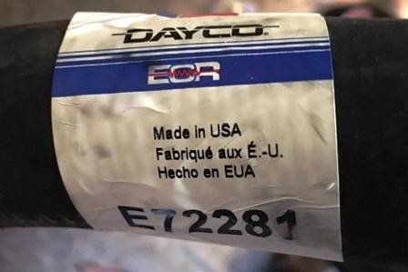

The lower radiator hose for a 2007 Dodge Magnum 5.7 L looks like it would work well for something like this. I have some pictures somewhere. I'll post when I find them.

I actually have a pic of that hose on a slant, but I am having trouble locating it. I have a 2007 Magnum and happened to notice that it might work on a slant with a radiator outled on the driver side. You may need to use a tie wrap or two just to keep clearance for the belts.

I took a 90 bend off the rad and ran a 12" piece of PVC to a flex hose up around the timing cover. worked great but if that 72281 Magnum hose works, let us know! Im running an early Mustang Aluminum radiator.

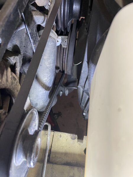

OK, I finally found the pics I had of the Magnum hose on a slant six.

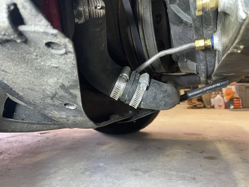

Ok, I got this figured out.
I tried the magnum hose as recommended and it was a no go, because my alternator is on the passenger side so the hose would actually go through the belt which made it impossible to ensure it doesn't rub. I ended up getting Dayco hose E71317 AND used the stock hose. This dayco hose has a 1.75" inlet for the rad and shrinks down to 1.5". It was easy to route it over, strap it to the lower bracket and connect it to the stock hose (with minor trimming) and a billet coupler I found on amazon. This combo seems to work really well and I will see if I can get some good pictures.
