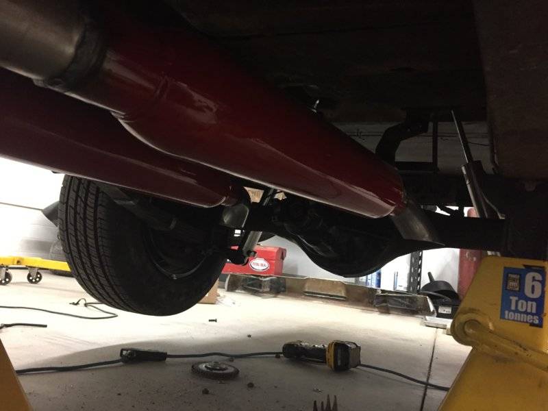

Dumping exhaust down under the car
I've been running mine that way since last summer. No regrets so far.
With a 5.9 Magnum, Doug's headers, 2.5" pipes and Jones Maxflow, the car is NOT loud. You guys with high compression will likely hear more of a noise difference in the cabin than I do.
Cutting the pipes did shave a not-insignificant amount of weight off of the car though. The pipes are hanging on the wall in the garage. I'll need to weigh them but I'd have to guess that it's 15lbs or so of dead weight off the car. :)
Sitting in traffic, the fumes are more noticeable than with the proper exit location. It's not a serious problem, IMO.
Ran mine that way for years. Don't know why there's an issue at car shows, are they held in dirt lots? Got pulled over one night, the cop told me I needed tailpipes. Didn't write me. I hung some fake 12" tailpipes at the bumper, no issue after that. Even had a guy at the cruise spot tell me it sounded better with the tailpipes!

While I got you guys attention. I also don’t want to dump underneath. I know it’s hard to get the exhaust to come out the back using 2.5“ pipes and extensions and going over the axles. Question is aren’t there smaller gas tanks that would fit that might not be as wide in order for the pipes to run along side? Don’t want to use a cell either. Anyone try it?
Sorry if I’m highjacking your post but thought it may be relevant.
I ran 3 inch TTi from the headers to the bumper on my 70 with stock fuel tank, 8.75 diff, no clearance issues. They are not cheap, but I believe you get what you pay for.
The only people who are having trouble running tail pipes are those of us with mini-tubs and big tires. Space is very hard to come by.

3" pipes to the rear with tubs, and inboard springs is quite common.
there are several posts with pix here.
You need to find a craftsman that WANTS to do it.

Agree , hard to get 3 1/2" duals past a stock tank w/ offset spring hangars ! lol

I forgot to mention the one year only 67 tank and that we are using mandrel bent pipe. No one around here even has a mandrel bender. We mocked up the front half of my exhaust using drier ducting and expanding foam, and then shipped those pieces out of state to be copied in stainless. You were right about one thing, you need a craftsman.

My son used pre-bent u-tubes, some cutting and fitting as best poss.
As with most first attempts, he'll do a few things a little different next time.
Your transverse tank strap should be fine as the tube sneeks out on top of the spring, below the frame, parallels the spring, then tucks back in behind the tank, to very near stock tailpipe location.

We're thinking along the same lines. We bought a set of mandrel bent 3" tail pipes for a Nova from Pypes and we think we may be able to cut them up and have the exhaust exit behind the tire. Not exactly what I wanted but it's better than the noise I'm getting at the axle now. My tank is new but yes, it's been massaged a little here and there. Thanks for the help!

So I just wanted to amend these comments.
I got to thinking about my turn-down pipes that came out of the mufflers...and it occurred to me that these were 2.5" OD so they sat inside of the exit pipes on the mufflers...which likely introduced a bit of restriction.
So I popped the turn-down pipes out and now have mufflers pointing straight at my rear axle (not ideal obviously) but the damn thing is a bit louder and sounds better! Who knew? I'm liking the Jones Maxflow quite a bit more now.
