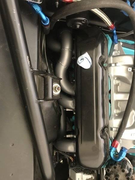

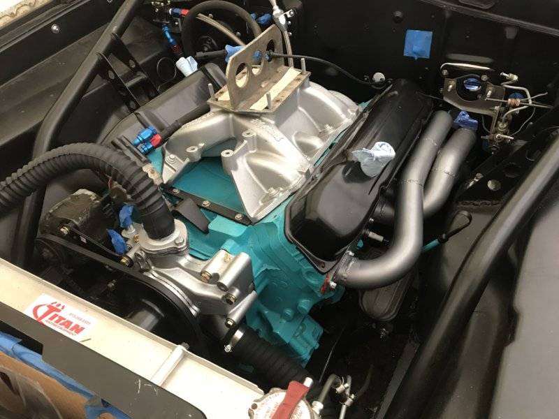

I don’t think I ever uploaded finished header install pics. Here’s something to get you inspired
Very nice fabrication. Any pictures of the underside. Tube size ?
Thanks, I went with 2” primaries into a 3” collector. I’ll post some decent pics of the underside when I get it up on the lift at work this winter. Has a full exhaust now that exits in front of the rear tire.
The color is “raw steel” ceramicoating from a local place here in Portland, OR.
