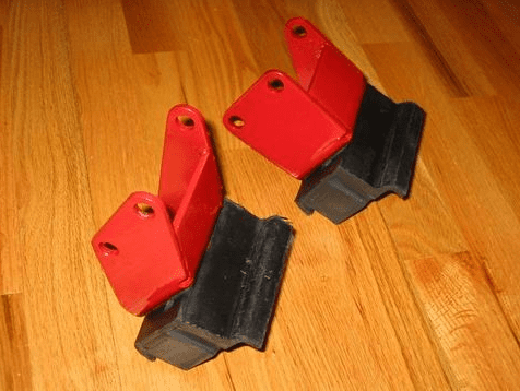

Since this Schumacher guys are still out of business it seems, I am trying to see if I can fabricate some engine mounts myself. I have a set of 67 and up 273 engine mounts and a set of 80's truck mounts for 318. I am thinking of using these two sets to make a good one for my application.
Do you guys or somebody you know have some good dimensions for the early A V8 engine mounts? A sketch, hand drawn schematic with dimensions, angles, holes location?
Thank you,
They should look like these.
Others will chime in, but try the search box. Plenty of threads on this with design drawings
When I put a 273 in my 63 dart in 1980, we put the 273 and transmission in the car and held it in place with jacks. We then used cardboard to mock up the engine mounts and then transferred the cardboard to steel and welded them together.
