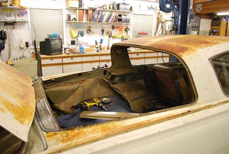

My '65 FS has body cracks under the rear window, and I've read here on FABO that they are a known problem. The body has been media blasted and each side is slightly cracked through the body lead at the seam there. I bought subframe connectors and plan on installing them in an effort to keep this from coming back, but my bodyman asked me to find out what others have done to repair the cracks. Any special tricks for a better repair than just filler and hoping that the subframe connectors fix the problem?

The cracks appear at the base of the rear window about an inch back from where the sail panel meets the quarter panel. They appear at the same location on both sides, have a look at these photos. I will try and get better pictures as the work continues.

I never knew it was a thing on the 64-66 Barracudas until I saw this thread. I went out and looked and sure enough, mine was cracked just like the one in @Bob Jasinski pic he posted. If you dug all the old out, welded it solid, sand blasted it, epoxy primed it and then did the initial fill with either All Metal filler or Tiger hair, then finish worked it with Rage Gold it would probably be fine.
