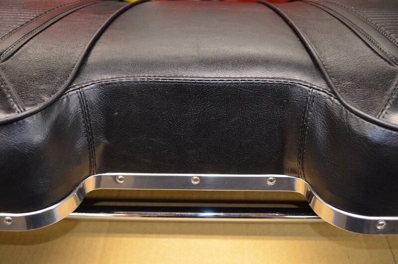

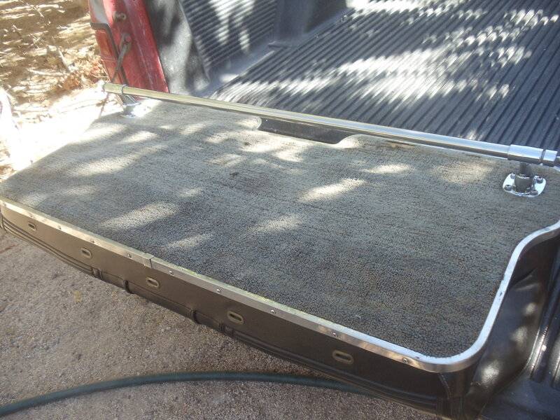

First a question: Are the rear seats all the same 64-66 Barracuda? Thank you.
Is the factory rear seat back fairly heavy (weight-wise) or am I just losing muscle tone in my old age? Carrying that thing around it's quite a chore for me these days. I read somewhere that old seats can become heavier with age as the foam "absorbs" who knows what. Thank you.

F yeah, try to lift its bucket seat out over a fender! No wonder the A100 seat are popular with racers......
Beautiful seat! The lock bar makes a good handle.

Seat frame is the same 64-66, but 66 upholstery is different - seats and door panels. Edit: I should clarify that the REAR seat frame is the same. 66 front seats are different than 64-65 seats. Seat you have is 64-65. Here's a 66:
Back seat in my 65 weighs 70 pounds. Bottom is pretty light, so most of the weight is in the back. Don't know about foam absorbing moisture, but I don't think the back seat has foam. Or not much, at least. But my back seat upholstery has never been off, so I could be wrong. At any rate, I'd guess most of the weight is in the metal frame, the chrome bar and the brackets for being able to fold it down.
I reupholstered the rear seat back and bottom for my '65 using a Legendary kit last Fall. The seat back uses no foam, only jute and cotton batting. It is very heavy, most of the weight comes from the solid steel back, springs, hinges, and latch bar. I thought I'd hang it on the wall to save space but quickly gave up on that idea. Here's some pictures from the process. Getting the dip just right in the center is difficult, as is figuring out exactly how many layers of cotton batting are needed to get it just right. Had to redo the cotton batting a coupled times, it took less than I first tried. Legendary has videos online that help.
