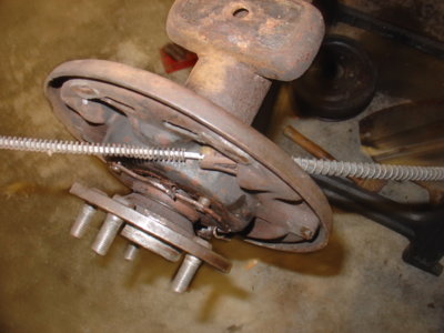

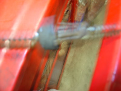

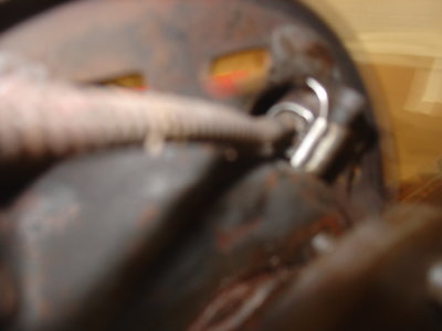

Just get a wide old hose clamp.
I use the box end of a 14mm wrench and slide it over the shoe end of the cable down to the back plate.
Turn the wrench back and forth a little while pulling the cable and it pops loose.
A 9/16 is just a hair loose, but works with a little more persistence.
I always used a boxed end wrench. 7/16 if my memory serves.
I also use a box end wrench. Hose clamp is a great idea!
Bet next time i still use a wrench...
