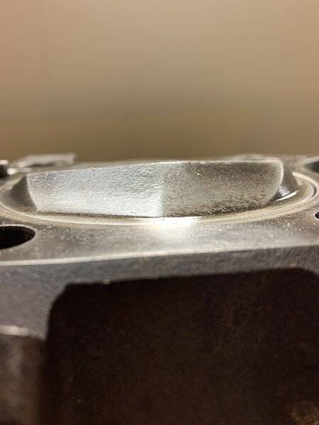

Factory 71 specs per NHRA are around .45 Above Deck with 028 gasket
and that is exactly where we run then with alum heads.
I have been mocking up a 340 I am putting together, the TRW forged replacement piston is. 013 above the deck. So I ordered the Cometic .027 head gaskets for the X heads I am using

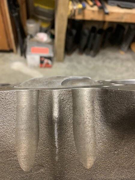

There’s plenty of room for steel shim head gaskets with X heads. The last pair I measured had been cleaned up (probably .007) and still averaged over .080 deep on the shallow side of the chamber. They measured 72ccs with stock tulip style valves. A .020 cut would put you around .044 piston to head with the I believe .018 thickness if your heads are close to that (.060+.018=.078-.034=.044). The greater problem I’ve seen with ChryCo iron heads is there’s usually 1 end chamber that’s cast at less than half of the depth of the other chambers. I’ve got a five inch base depth mic that is great for showing the inconsistencies in the chambers of a regular production head. .020 depth variance is about the best I’ve come across so far.
