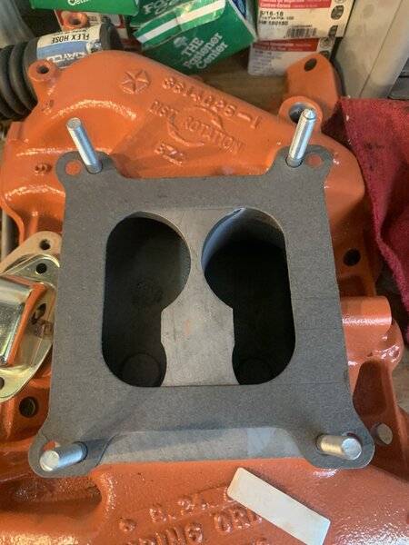

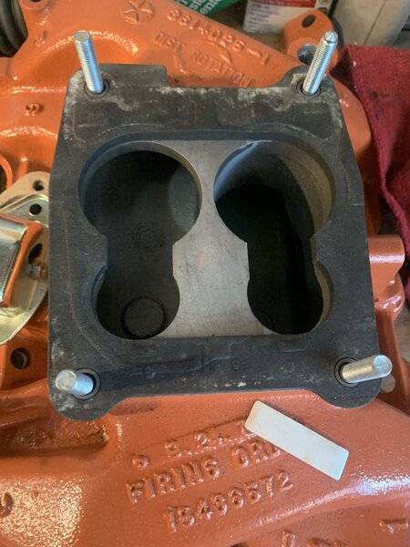

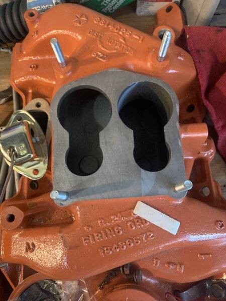

No adapter necessary....although Edelbrock does make a thin metal spacer to assure there are no leaks about the secondary bulges. BUT, you don't even need that if you use the wide perimeter gasket like in @rumblefish360's photos up there^^^^^^. Even still I recommend it because I've seen them bolt on and work great and the suck that gasket out because there's such a small amount of contact area back there. This is it.
Carb Adapter #2732 for Edelbrock Manifolds Only, Square Bore-Spread Bore .100in
No need for all that thick 1/2" or 3/4" stuff. That will do the trick and be on there forever.
What gaskets do you have? I believe the thick insulator gasket will solve your problem. Besides, you need it anyway to help keep the carburetor cool. The gasket you need is like over 1/4 thick and has the anti crush plastic washers in the corners.
I got the 1/4 inch one on the way in the post
