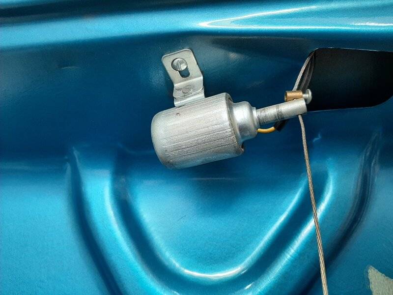

My 1970 Swinger 340 came with this when I bought it in 2007. I'm guessing it was dealer or aftermarket installed. They cut the tail down from the lock so it wouldn't turn the latch assembly. The momentary closed switch is installed under the head light switch. No part numbers, but could be easy to fab with a large 12V solenoid. Note the bicycle cable with "adjusters." The wires run along the trunk bracket and the wire harness with the trunk light switch wire. With the short tail on the lock to the latch, no power meant no trunk access. They fabbed a small bracket into the trunk latch assembly to turn the release when the solenoid had power. I'm guessing this wasn't Mother approved. Paul.
