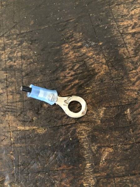

I think I found the problem - looks like I broke a ground (it is black - so ground) wire that was attached/grounded with the steering shaft retaining collar.
However I cannot find the rest of the wire - any ideas where the source would be?

The broken cable - which looked cut was a wild goose chase - who knows how long that has been like that - I just know it has been there since I messed with the column. And will not be going back into the car
