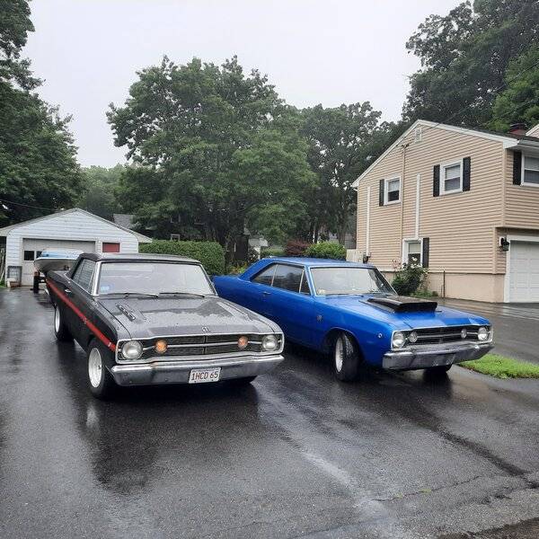

Here are some pics the outside of the body was painted by a professional restoration shop, The engine compartment I did myself out of 66 Auto Color spray cans:
I also did the trunk and the inside of the car since it was a color change for this project. It saved quite a bit on the overall cost of the paint for the project.
