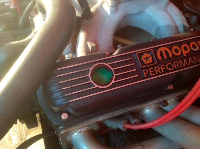

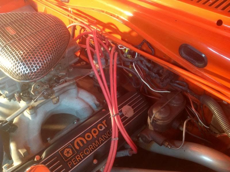

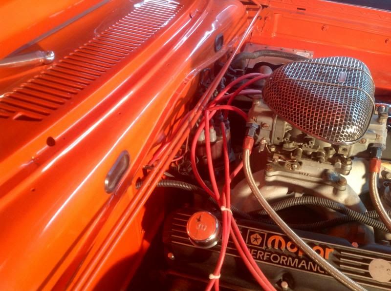

As a reference my car is Hemi orange and the valve covers were done in black and orange. But just the lettering in orange which I thought was more subtle and didn't overwhelm ( not too much orange ). I am working on upgrading the engine bay too. Pictures are taken during various work being done. These are the only pictures I have of them but can take better ones if you like. Hope it helps. ( Small block 360 engine block is black )
