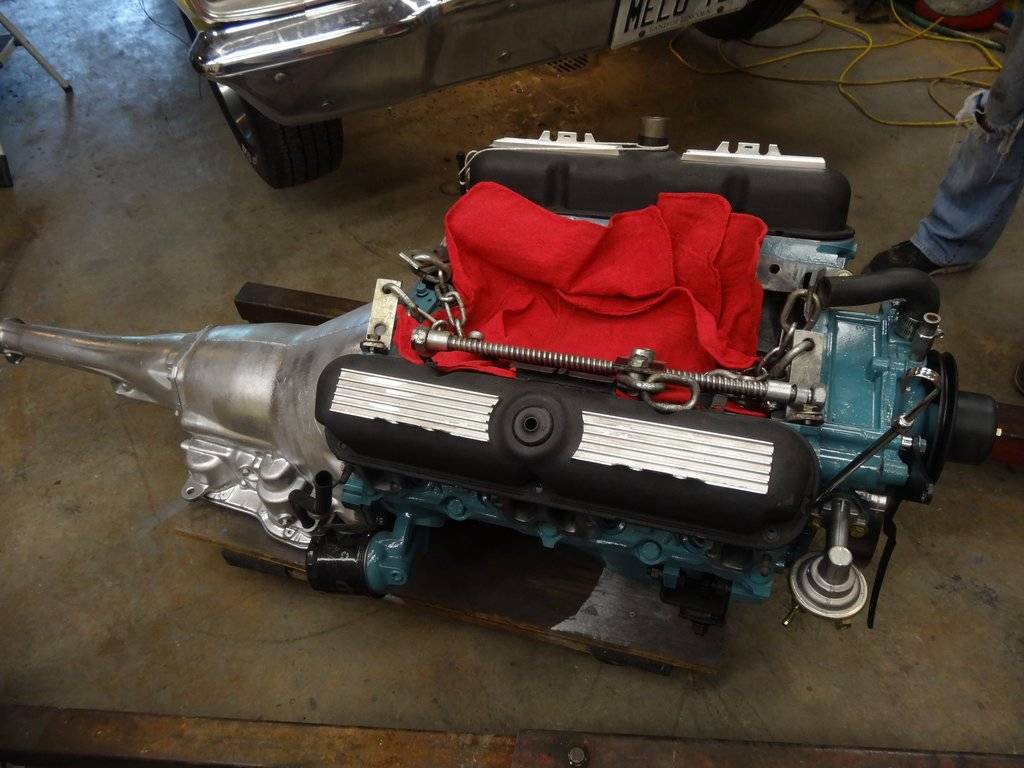

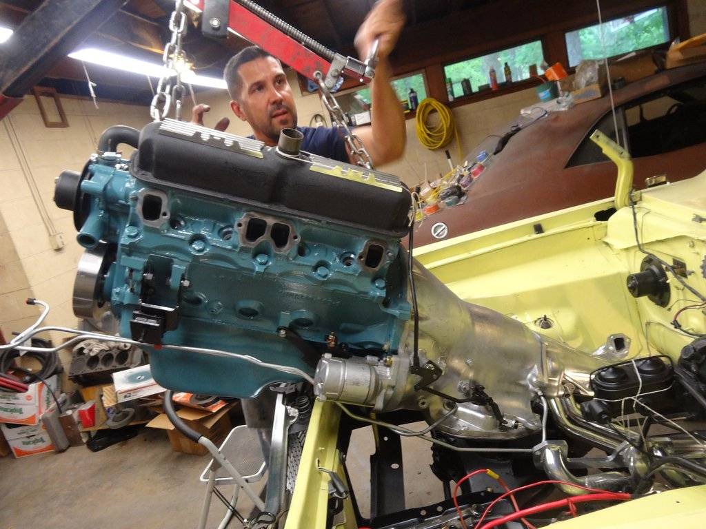

If you get an engine "leveler" then it's pretty easy to pull and drop the engine and trans together or engine only... It's nice to be able to angle it in and level it when you are lining it up on the mounts...

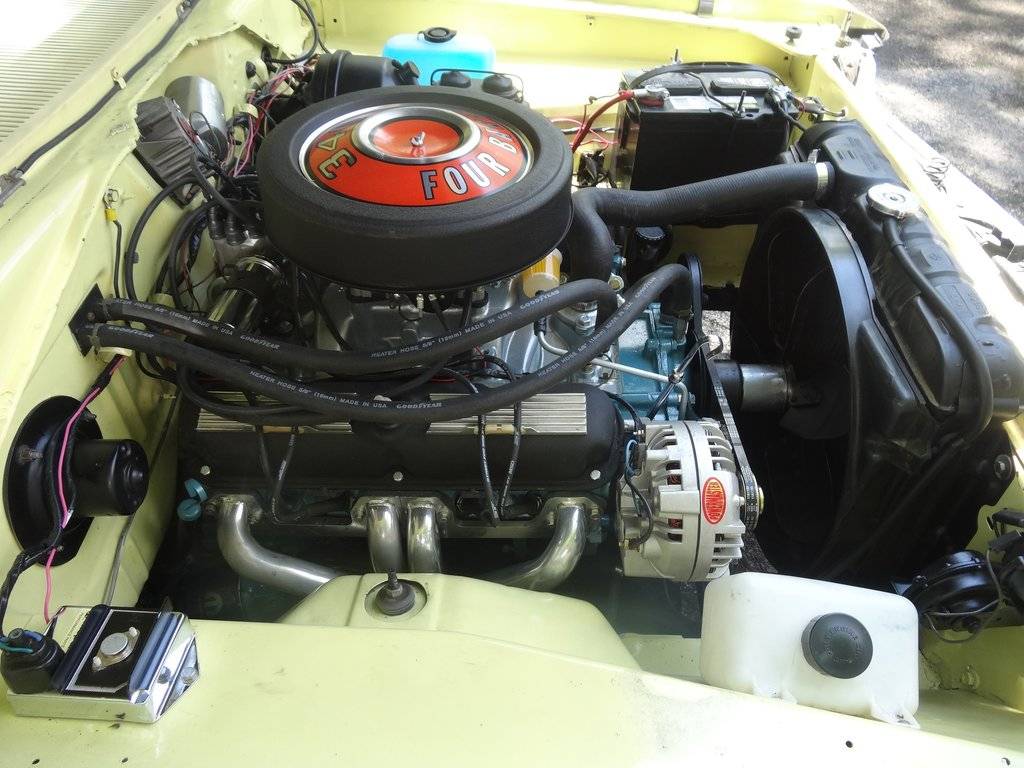

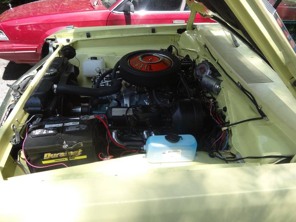

Here are the pics of the finished job...
