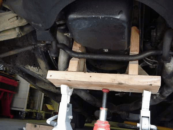

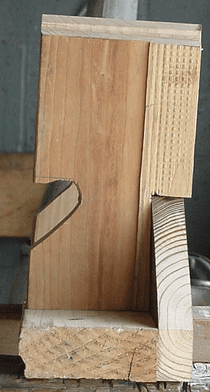

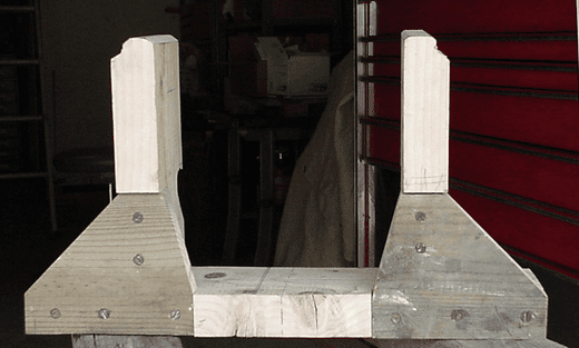

This is the one I made.
Made to be used with steering link as an additional support method.

Good idea, but can you steer the car and push it around the shop with the wooden support you made? The point of the one i made is it allows you to move the vehicle around including steering it with no trans in it.
Not really. It was good for rolling the car back (and forward) but would not work for turning.
