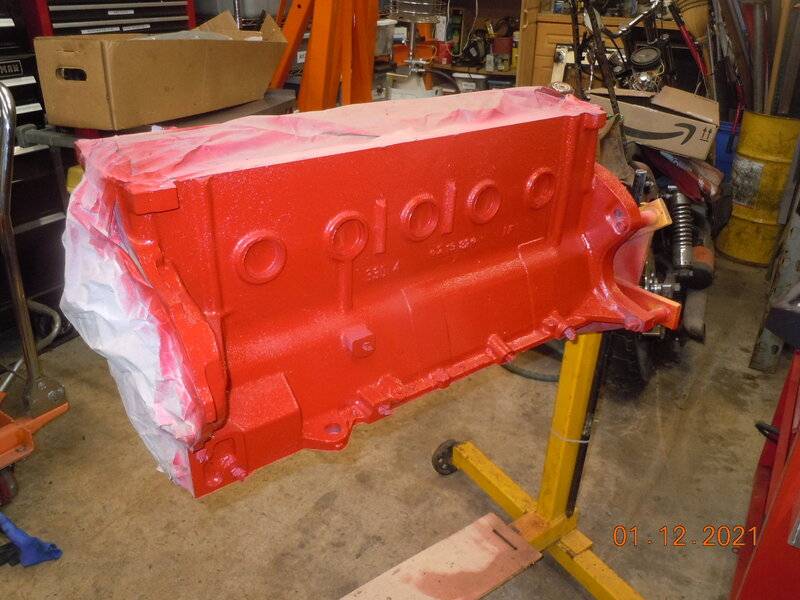

This photo is of the block centered too high. It was workable for the block only but VERY top heavy when the head went on.
This photo is a better balance. Note the center of the hub is closer to the head. Regardless of how you rig it, head on vs. head off makes a ton of difference in balance and roll. Be alert at all times.
