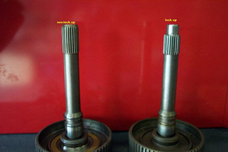

'76 is before lock-up converters.

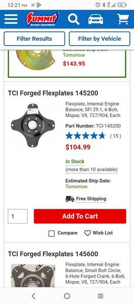

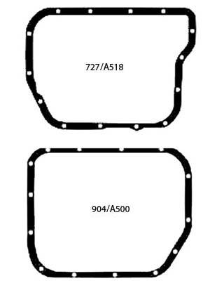

Yep! I'll add a link below for the flex plate to do just that. @Locomotion posted a pic above that shows what the pan gaskets look like on 727's and 904's. Open your hood and look down to where the trans dip stick tube goes into the transmission. If that front passenger side corner of the trans is square, it's a 904. If it has a kick out in that corner, like the pic of the 727 pan gasket above, it's a 727. There is a B&M flex plate available either way. The one in the link below is for 360 to 904. Whichever one you get, hold it up to your torque converter like it will bolt up to the motor. B&M flex plates are marked 'Engine side'. Make all 4 flex plate to converter bolts line up and then mark both the flex plate and converter at one bolt hole. Line that one up first when you go to bolting them together in the car. If you don't do that step, you will make up new cuss words when you keep moving it to get it to line up....and it does it the 3rd time you move it....lol

B&M Flexplate
