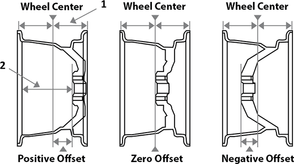

"Offset is usually stamped or engraved into the wheel and is measured in millimetres of 'ET' [ET is the short form of the German word 'Einpresstiefe' which literally translates as 'insertion depth'] Positive Offset wheels have their mounting face toward the front face of the wheel"
So yes if you go from +40 to -9 you would be moving the centerline of the wheel 49mm outword. (About 2 inches)

ET is distance the back of the mounting flange is removed from the centerline of the wheel

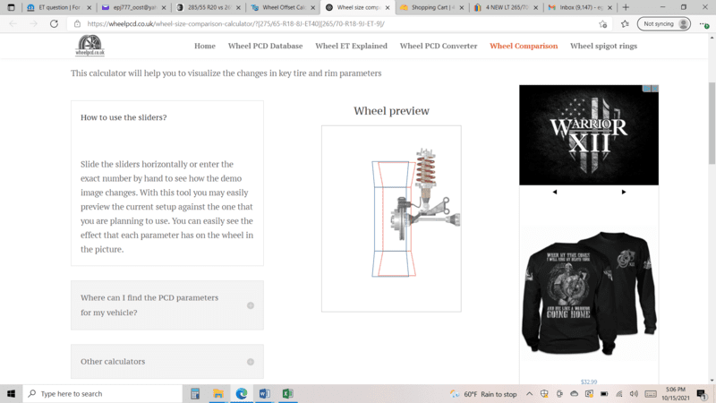

in the mean time, here is a website that shows what the comparison should look like with the stock wheels
Wheel size comparison calculator (wheelpcd.co.uk)

ET is the position of the wheel center in relation to outer ring of the rim. So a “0” ET puts the center of the rim right in the middle of the outer ring (the lug mounting area) A negative ET puts more of the rim and tire towards the outside of the vehicle a positive ET puts more of the rim and tire to the inside of the vehicle. So your ET of 40 puts the wheel to the inside of the vehicle. All things being the same the -9 would move the outer wheel towards the outside of the vehicle by 49 mm from where the current wheel is.
Wheel Offsets Explained - Konig Wheels
There is, IMO, a very good reason companies went away from the old "offset" system . Offset tells you something ......... but it is by itself, a useless number, in that you have to also know the rim width to calculate where the rim will end up.
Whereas backspace tells you right off, no math required.

so..this is what im looking at
the first one is OEM , the second is what i am looking to buy

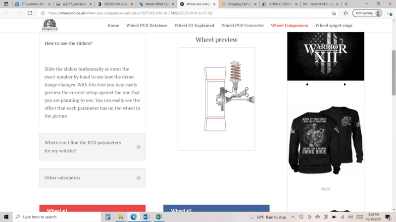

and this is the comparison with what i "believe" is on there, and what i want
so, if i am correct then the new wheels will be just as far out of the suspension, but because they are narrower, they will stick out less
so are we all in agreement this will work?
here is the same picture, but only with the rims
(red is OEM blue is what i want)
and for comparison, red is what i think i have, and blue is what i want

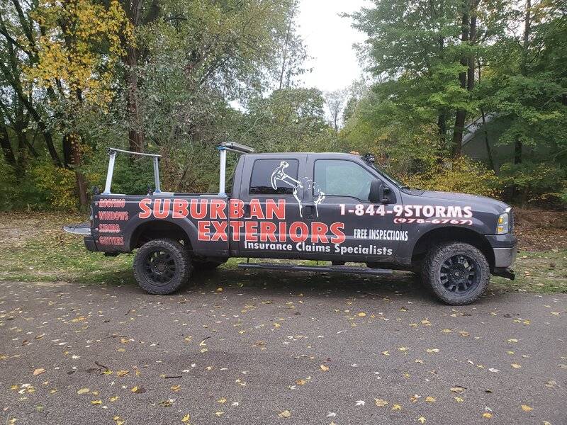

For reference, here is a shot showing how far the wheels stick out now
sure did, but i got the little wooden slat sitting pretty level on the tire, and there is no bend to it
who knows, the new setup might actually fit into the wheel wells

Got the new wheels on
It turned out I was wrong on the specs of the old wheels, they were 20x9, ET0
All in all, I think I tucked them in a whole 1/4 of an inch more, but the thread pattern is probably a good inch narrower, which should help with snow...and I much prefer the looks
