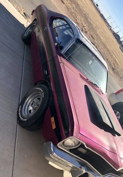

I’ve been out of this scene for quite some time now and needless to say I’ve lost whatever knowledge I did have. So I come here seeking help I’ve been having a hard time acquiring on the web. I currently own a 1974 Dodge Dart Sport. I believe it’s all original, as I wasn’t given much info when I purchased the vehicle. My ambition for the future are a bit more than what reality is now for the car now. So what I’m seeking is info regarding any sort of upgrade I can do to the cam without having to do much else on the top end. I’d like for the car just to have a nice sound to it. As you can tell, at the moment I’m not looking for an entire plethora of power. It’ll just be a weekend cruiser. No track or drag days in the future. Thanks guys.

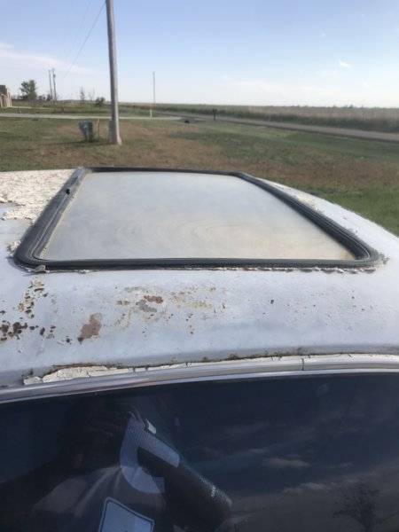

A 74 with a raisin bran hood AND a sun roof??? There is a web site just for these sun roof cars. I keep forgetting to join it.
Very cool car.

Great looking car too, I have a '75 Sport currently, have previously had a '74 Sport and another '75 Sport, along with several other A bodies.

Alright, the carburetor is an Edelbrock 600 sitting on top of the factory intake. It is equipped with 1 3/4 long tube headers. The rear end appears to be 8 1/4 so I’m assuming with standard 3:21 gears. It’s missing the fender tag, therefore I’m unsure of many factory options. A roll bar was installed at some point. It also has what I believe to be the original 4 spd transmission. Someone made a mention about the sunroof and tbh, I thought it was aftermarket due to the fact that there is no crank lever to open or close it. As mentioned, I plan to just drive this vehicle on weekends as I have an 80 mile round trip commute to work. Again, I appreciate all of your help and knowledge.
