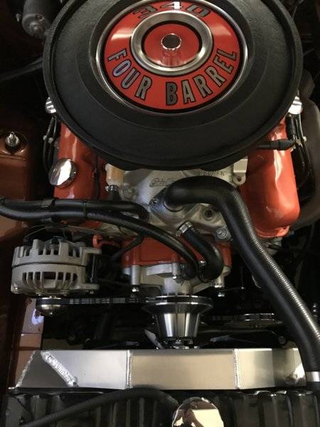

    Hey guys, so i will have to replace my leaking milodon water pump and figured while the coolant was all out it i was thinking of swapping out the factory style 22” radiator for a aluminum one, i already have the aluminum shroud from wizard cooling and was looking at getting one of their radiators. They offer both 1” tubes and 1.25” tubes? both have 16 fins per inch, is there such a thing as too big of radiator tubes? Right now with a mechanical fan and clutch and 180 degree t-stat in the summer i may see 195 with the factory style radiator

    Bigger the better, but Make sure the width of an aluminum radiator will work for your setup. That has been a real issue for me.

    the thickness of the factory style right now is right at 3” from mounting flange to where the shroud fastens, according to their dimensions the wizard radiator is 3” thick with both the 1” and 1.25” tubes

      My biggest concern is i dont want to over cool the engine. Before i installed a fan clutch with a fixed fan i rarely saw over 180-185. With the clutch fan setup it stays between 190-195

      There is no such thing as “over cooling” an engine. That’s what the thermostat is for. It controls minimum operating temperature.
      You are much better off with the best radiator you can fit in there and let the thermostat do what it’s designed to do rather than skimp on a radiator and fight cooling issues.
      With that said, 1.25 tubes all day long and twice on Sunday. Do not skimp there. Find a way to make the rest of it fit.

            I guarantee that the radiator cores are copper... tanks may be copper/brass alloy. Copper cools better than aluminum but some aluminum radiators have a different design that may make the equal to copper/brass.
            An old fashioned copper fin and plate design radiator will out cool any other radiator design regardless of the material. That's what Peterbilt used in their 379 models that I owned.
            I had one of those plate radiators from a Lincoln in an early latemodel stock car and it was a chore to get that 427 up past 160 degrees in a 50 lap race.
            I think an aluminum radiator in a vintage car looks out of place and most don't cool as well.

              It’s NOT just about flow. It’s about surface area too. If you look at the thermodynamic equations that govern heat transfer, the two biggest components are surface area and flow.
              So no, you can’t just say bigger tubes and fewer rows are always better. That’s 100% not true.
              It’s a balance between flow and surface area. The Champion 3 row radiator, with .75” tubes, cools my .060” over all iron 340 pushing 400+ hp just fine. And I drive it all summer in temps as high as 110* F. Giant tubes are just as much of an advertising gimmick as adding more and more rows. You don’t need (or want) a 4 row radiator, just like you probably don’t need or want a 2 row with 1.5” or bigger tubes. Anybody that says different is trying to sell you something. And probably never had any education in thermodynamics.
              Between a 3 row with .75" tubes and a 2 row with 1" or 1.25" tubes the cooling numbers would come down the specific manufacturing details of that radiator. But I've seen both work just fine in an A-body, so unless you have more than the published information saying one is better than the other is just personal bias.

                I just went and looked, my factory style radiator appears to have 3 rows of tubes and they look to be 1/2”

                I’m not disagreeing. I said the 1 inch tubes are plenty for what he is doing. And yes, it’s not just about tube size. I’d take two tubes (or in the case of my truck) one big tube over 3 or 4 all day long.
                It’s also important that there is turbulence to keep the coolant in contact with the tube no matter what size it is.
                I’ll say it again. It pays long term dividends to fit the biggest radiator you can, run a high flow pump as fast as you can and still keep the belts on and let the thermostat do its job.
                It would be educational to test and see how one or two cores compare to three or four cores compare at various flow rates.
