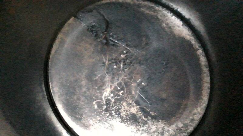

Thanks. I wasn't sure if there was a certain feature X distance from the deck surface that could be used as reference. I can check the head at least. The pistons are a good bit further in the hole than they should be for a stock bottom end, so I have no idea what the bottom end is.
Attached is the bottom of a piston, it shows the only identifying mark on it, the other pic shows how far down in the hole it is. Don't mind the carbon on top. Lol
Actually, looking at that pic, either the piston isn't sitting parallel to the deck, or I have a ton of carbon on that one side! Might run some Seafoam through this once its back together and running!

Is that a quench dome ?
Somebody might have milled the crap out of the 915s, trying to get some compression.
A 69 motor shouldn't have what looks like 1/8" deck. If it's got 8 to 1 replacement pistons in it, it would explain the swap to 915s for a little grunt.
From the bottom, they look like cast replacement pistons.
Was 8 to 1 even an option in 69? When I was looking before, I thought 80 thou was the furthest down they would be with a stock piston.

I can't find it now, but I believe I read so.ething that said stock pistons on the base 440 were .090 in the hole and the HP 440s were closer to .020 in the hole. It's hard to tell from a borescope picture, but mine do look more than 90 thou down.
I'm NOT familiar much with what is available in cast pistons. But in my old trw catalog there were at least four different forged pistons for a 440.
There were the Sixpack replacements that were somewhere around .020 down. There was the domed 2295 (11.5 to one,Hah!) that were about .050 down, another flattop that was about .080 down, and one that was more than an 1/8. (wanna say, .150 or so)
If you have a stock replacement, for a LATER 440, c.r. could be anything from 7.4 up, with 906s,346s, or 452s. I still think somebody tried to crutch a bad piston choice with a heavily milled closed chamber head.
That piston isn’t anywhere near tdc. Kim
It sure is, at least in the pic of the combustion chamber. You can even see the carbon buildup on the sides of the cylinder showing the piston doesn't go up any higher.
Like I said, I feel like they built this motor with whatever parts they had laying around.
