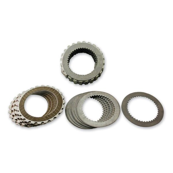

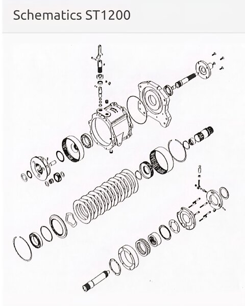

I don't know what a 400 pack looks like. I would hazard to guess they are proprietary for Lenco. Ill post up some pictures. 8 discs 9 steels. This is in the ST1200. Rated to 1200 hp.
There was an extra steel at each end and 1 was thicker. Selective thicknesses available to set pack clearance. Lenco sent me exactly what was in it. And there tech people are great and answer the phone. Are these 400 style?
I did a quick search and people said they are based on old C6 clutches but the inner teeth are shorter (which you can see in your pics) and it's not worth trying to modify ones to fit.. $200 wasn't bad at all from lenco, i was just more curious is all
Never been into a Lenco, but I understand the basics. Can you change gear ratios in the planetaries?
I thought you were a bad *** before I knew your car had a Lenco in it. Super cool.
Haha that's funny. Each Lenco section has 2 speeds. You engage the section by manually compressing the clutch pack,you activate its other gear. They have infinite amounts of gear ratios available. Whatever your 2 speeds are in your section are matched by the gear in the next section both in front and behind. Im not sure if you get different sun gears or planetaries. They helped me choose my gears. They tried to set up each section so that when I shift into the next gear it drops right to the sweet spot on the torque curve. My dyno sheet helped.
