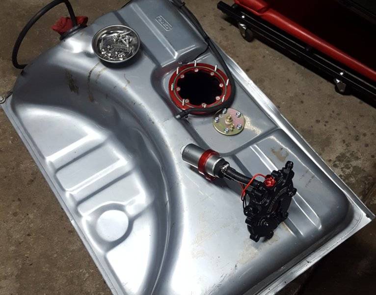

Finally got some time.
Just to recap, this is FiTech pump #2 that they sent me, fuel pressure gauge hooked to short line off of pump. I've tried more than one gauge as well.
Pulled tank, pulled red plug, looks fine, o-rings look fine.
When I pulled it gas dripped into tank, must be doing it's job.
Put regulator that came with pump in, primed pump with key, same crappy psi.

I ran some tests with the tank completely removed, gauge on the pump housing outlet, hooked to a fully charged battery.
First with the old new pump and the new regulator, then with their 'plug' in the pump housing.
Same crappy psi.
Put new, new pump in, new hose, and I didn't bolt the pump housing in completely, just 4 of the 8 nuts.
Hooked to battery, gas leaked out the top edge.
What the?
With the red plug in, there is no return, gas should just deadhead at gauge.
Even with their regulator in their pump housing, gas would return straight down.
So, I think I know the issue.
FiTech says, don't put a clamp on the upper end of the hose, it is a barbed fitting, the hose slides on, and you cannot pull it off.
Put a clamp on the lower end at the pump.
Problem is the hose gets soft, expands, from the pressure, then leaks. They will tell you this, and told me multiple times, so I replaced the hose multiple times.
A clamp won't even fit there, I tried. It hits the tank mounting ring in any position.
A longer fitting would allow a clamp, but the housing is aluminum and I don't think I could find an aluminum fitting around here.
I never would have known the upper barb fitting leaks almost immediately if I didn't leave 4 nuts off when I tested it.
Gas sprayed right at the top horizontally towards the pump housing o-ring.
So, I cut another new piece of hose, made sure it was perfectly square, slid it over the barb fitting, put it all back together, 100psi.
Put the tank back in, hooked everything back up, 58psi at the throttle bodies, nice!

Why the hell would you have a hose at 100 psi on a barb without a clamp on it is beyond me.
would a snap ring style clamp fit up there ?
I understand your frustrations. I would NEVER use a barbed fitting for 100 PSI, it's crazy. It's just engineers being pushed by the company to save a nickel on each unit. I see this exact thing with the analyzers I work on. Our Nox analyzer used to use Swagelock fittings inside but since the new "improved" analyzers with barbed fittings inside came out we have nothing but leaks.
I sent an email to FiTech requesting a call, they called me today.
They have been very helpful.
Today I found out the pump housing and pump were made by their sister company, Hyperfuel. Maybe I'm dumb, but I didn't realize that, it has Hyperfuel on the top but FiTech on the actual pump.
They have parted ways, so I asked if they have a new sister?
So I called Hypertech, an actual person answered, then transferred me to someone who was extremely helpful.
A long discussion, he grabbed the pump in question, we went over possible solutions, and he took my info and said he would call me back.
2 hours later he called back. He said they didn't have anything in house, so he went out in search of a proper fitting.
He's sending me what he came up with, fitting, some kind of efi low profile clamp, hose, and a new o-ring for the top of the housing.
He said he has never received this feedback, and would they would be working on an improvement to the pump.
He made it clear he believed his solution will work. I made clear my skepticism.
I will say that he gave me what I needed most, someone to listen, physically hold and examine the same parts while we're discussing them, understand the issue, and make a real attempt to solve it.
In the last few months I bought many new parts that were crap from the word go. To be able to call a company and say, I bought your product from someone else, long ago, and they immediately take responsibility is a win, I need it and I'll take it.
I'll also see what I can find for fittings.
I hope this works.

This sounds promising. I look forward to hearing how it works out.
And yes, you can use brass fittings in an aluminum case. Just be mindful of the threads to prevent galling.
