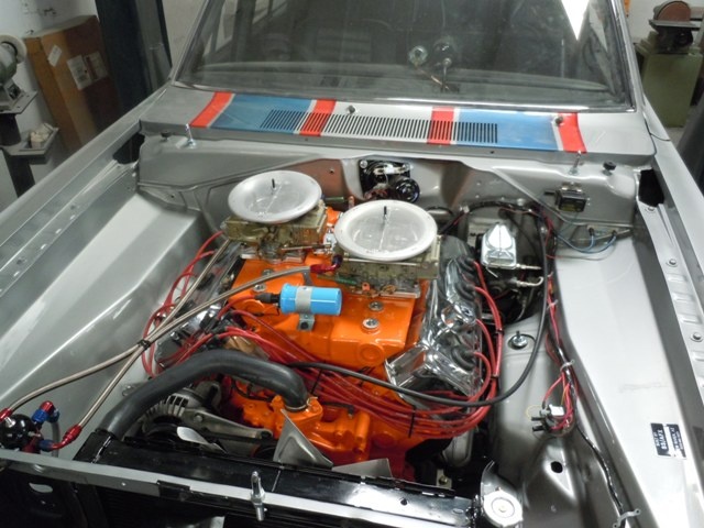

Here are a couple pics.

i was assuming a gen II hemi! but looking at the pic it looks roughly the same width in the places that hurt! with the offset plate you might be able to run P/B with the small diameter boosters, think its an 8", but why? manual brakes stop just as good...
