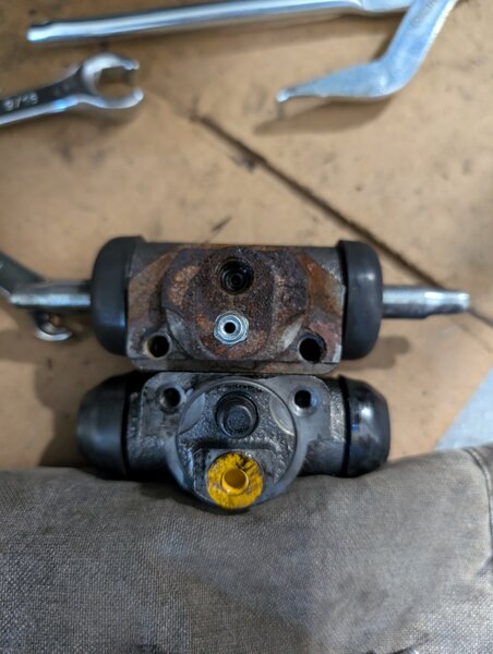

I have the Raybestos MS36406 dual pot master with 15/16" bore ordered from Rock Auto. Currently there are new rear wheel cylinders installed that are stock units, (Dorman W78734) that are 15/16" (.9375') diameter. Rear brake shoes and drums (10") are new by Wagner. I know many have used the factory style "Texas" shaped distribution block with built in prop valve (I have a used one) but do not like it for a few reasons. First, it doesn't fit very well in place of the old brass drum-drum block, I'd have to drill some new hole(s) in the frame, I don't want to install the warning light in my dash, and as far a I can tell, it is not adjustable.
I've read in a number of places it would be better to go with a smaller diameter rear wheel cyls of 13/16" to provide better balance with the front discs. I'm willing to change these new ones out (system is still dry) but is it really needed with the adjustable prop valve? If I did go with smaller rear wheel cyls, would that eliminate the need for the prop valve? This will be a manual disc/drum brake system, and the car will have modern radials, same size all around, close to factory diameter but on 15" Ralleye wheels. Input is appreciated.

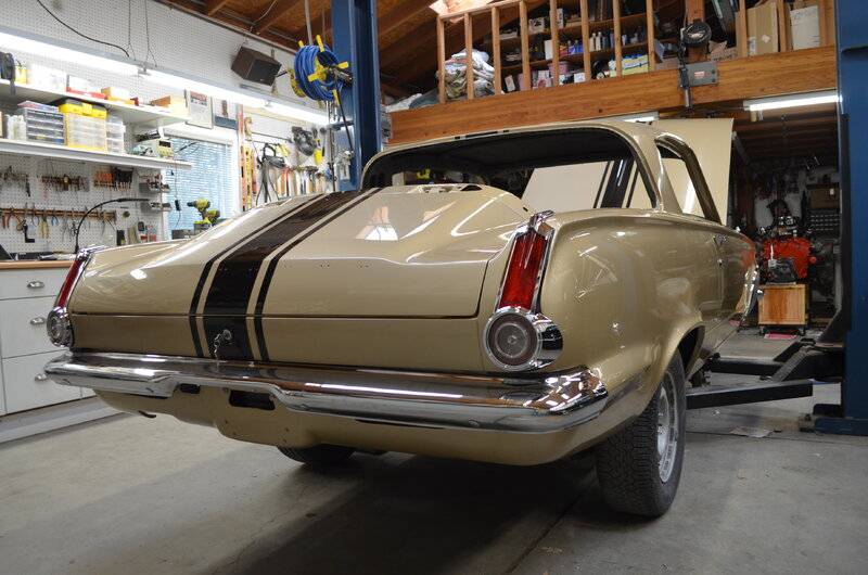

Here's some current project photos:
View attachment 1716363467View attachment 1716363468View attachment 1716363469View attachment 1716363470View attachment 1716363473

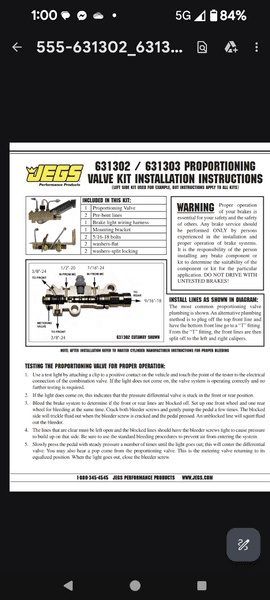

I looked it up on Jegs website. Yes, its not correct for your Barracuda, its a GM valve. That's why you had to add the separate adjustable valve. As Rusty indicates in post #10, the fixed proportional valves are specific to the car design.

I installed a budget system on a 66 barracuda and a rear proportioning valve was needed to prevent early lockup. It differed from your setup in that it was not the factory KH 4 piston calipers.
