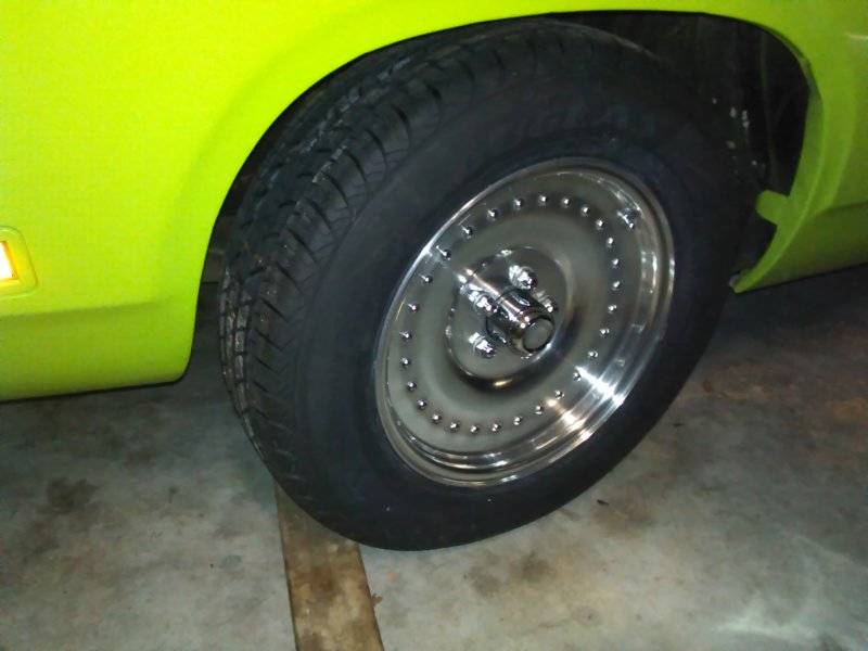

This is the 215/60-15 replacement on the left, and the original 205/70-14 on the right. Pretty close in size, and they are both about 26 inches tall. That is about the maximum height that will clear the front lip of the fender.
15" Centerlines 205.65.15 - 8x25.4
