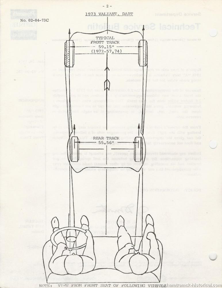

There is a tech article about the 1973 up tracking different from 1972. 1972 track width is 57.74 so if you measure the early A as shown with original wheels you should have the answer.

The AMA and MVMA specs show the following (I believe the governing body name changed, but the charts appear to match):
1964 Valiant tread - 55.9 front, 55.6 rear
1974 Valiant tread - 59.1 front, 55.4 rear
Note that wheels probably affect this some, as does the possible additional width due to disk brakes available on the 1974 model.
