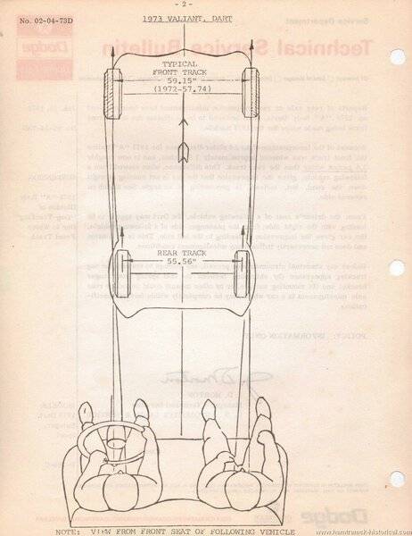

TSB from the Hamtramck Historical website (which has a lot of useful information and lots of other TSB's). The full size picture is here and is easier to read https://www.hamtramck-historical.com/images/TSBs/1973/02-04-73D p2.jpg
